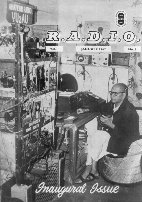

#33 erstellt: 17. Okt 2007, 09:05
sivat schrieb:
I wish my wife will allow me to do this.....
This is a photo i got from a friend of mine, who found in on the internet. It needs lots of courage to attempt something like ....most of the material seems to be vintage ex-mililaty style components.
If that was a mess than what would you call this !
Attaching a pic of the legendary Indian ham vu2au. Just note the cacophony of equipment and the gentle warning of “Danger 1000volts”
Interesting period equipments. On the wall I can see an RF Generator, a PIE super-heterodyne receiver and what looks like a true RMS voltmeter. Higher up I can see a WW2 headset
On the table it looks like a COLLINS ex-military transceiver which would typically be modified to operate in the 80 to 10 meter band SSB. This was the most common equipment in India. Next to it could be a the Watt meter unit or the antenna tuner dial.
More interesting stuffs are on the rack and and most appear to be home-brewed.. On the top I can see field tuning coils, inductors or ancillary equipments like noise filters and base station oscillators. On the middle row I can see a 6L6-G tube which would typically be used in the RF modulator stage or as part of the Beat Frequency generator for Single Side Band receiving.
On the bottom row could be a home-brewed transmitter centred around the 845 / 211 or 811A triode. The friendly 1000volts warning suggest these tubes. And noting from the eagle gaze of vu2au toward this bank one can assume that the transceiver was 'active at the time.
The pic would have been clicked around 23.00 hrs when most Indian hams are active.
