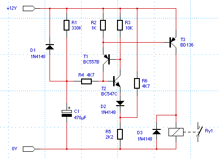

What about the delayed B+ i've mentioned ?
You're aware of that problem of a fully applied B+ on a cold Cathode ? This is shorting Tubes lifetime, maybe not drastically, but worth to think about.
Do you know a 'neat trick' to get around this issue by using SS rectification ?
Have to do that by myself for my Amp, but i dislike the fact of having a Solid State Circuit in my Amp and the urge to do a separate PSU for it, so, well..

Delayed Start:
Sorry I missed to address your comments on the soft start in my last post, which was made well past 2AM when I came home after lots of Last of the festive parties
I would not bother too much with a delayed start when we are dealing with low voltages. It makes more sense on something like an 845 or 211 where voltages is in excess of 1KV. However, a SS delay is a good idea. The “neat trick” would be a standby switch. But do remember to put your standby (or the relay switch) before the capacitor bank or on the return path. IMO the weakest link is the relay. Even the best ones start malfunction after a couple of years. You can not put in a more heft relay cause you are usually limited to a trigger voltage of around 12volts (doubled from the 6,3volt tap) unless a dedicated higher winding (or a separate transformer) is used for the relay. Not worth the trouble IMO. So my suggestion is a standby switch that you operate manually after 30 seconds or so of powering on the amp.
A do have a few proven schematics on the delay. Pls ask me if you need them.
A valve rectifier scores on this front. You get a built in soft start. Depending upon your choice of rectifier it could vary from 5 seconds to 40 seconds.

i wanted to add a delayed start to my Sixpacs & found a nice compact & reasonably priced unit made by one Sophia Electric in Washington D.C.
http://www.sophiaelectric.com/pages/parts/delay_action_board.htm
I never actually had it put in actually because I could not get a hold of the people concerned in that company! Maybe it was my bad timing that I was getting these changes done during the 2nd half of December & they were really busy or off during that time?
Anyway, this unit looks really nice, compact & could fit easily in most chassis. Anyway, just FYI.

screamgigi schrieb:
..my suggestion is a standby switch that you operate manually after 30 seconds or so of powering on the amp.
Good points here, i'll go for that standby Switch too in my Stereo and Tube rect. in my Mono's - i want those coke bottle 5V4G's / 83V's
In every case i'm interested in those delay schem's. If you would be so kind to make them available for me, that would be great, thank you.

#210 erstellt: 08. Jan 2007, 01:03
Hey bombaywalla!
This was exactly what i was looking for !
I just want to do it by myself 'cause i think i've a couple of fitting relays somewhere in my "collected goodies" box.
Thanks for sharing anyway !

Markus-ji
Try this. Works great. C1 and R1 control the delay period. Adjust them to your need. Get the best relay you can find preferably those used in industrial control instrumentation.
.:Bulli:.
#213 erstellt: 09. Jan 2007, 19:36
Hey screamgigi !
This looks quite simple, so i'll try that one soon !
Thanks for the circuit !
