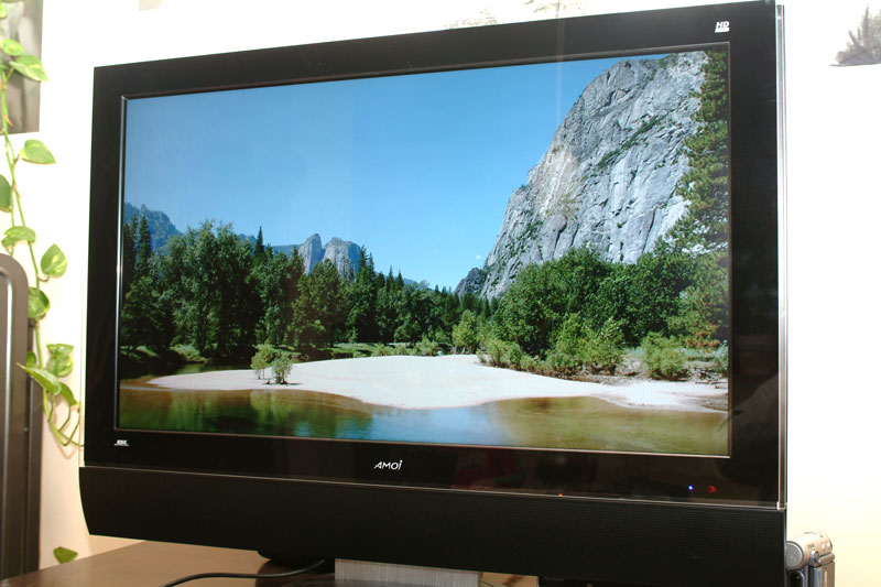

#360 erstellt: 13. Jan 2006, 18:54
[/url]mal ein paar Bilder zur Auflösungsdebatte.
Das erste zeigt ein Foto in der Auflösung von 1920x1080 Pixel über DVI->HDMI vom Powerbook auf dem Amoi.
Das zweite Bild zeigt den Abschnitt (rot), der auf dem Amoi dargestellt wird. Also nicht die vollen 1920x1080 Pixel.
...was auch immer das alles zu bedeuten hat.
http://www.torstenheppe.de/Images/amoi.jpg

#361 erstellt: 13. Jan 2006, 19:18
so it overscans like all TV
it's a TV problem... it treats all signals as TV signals (leaving out the borders that normally contain control signals) - you can see this if you use a computer monitor with an external TV tuner... the monitor doesn't know about the control signals and shows the whole image
I haven't seen many TV that can be "turned to monitor" mode - I hope somebody can tell SPB and Amoi that we want this mode...
btw, it looks f*cking nice anyway...
how many Hz is it?
ps. have you tried any 3rd party software (like Powerstrip for PC) to maybe change the Hz, phase etc. characteristics of the display? maybe we can trick the TV...

#365 erstellt: 13. Jan 2006, 22:42
Hello NLS,
I can chose between 50 Hz Pal and 60 Hz NTSC. What You have seen, was the 50 Hz Pal signal. But the NTSC looks the same.
