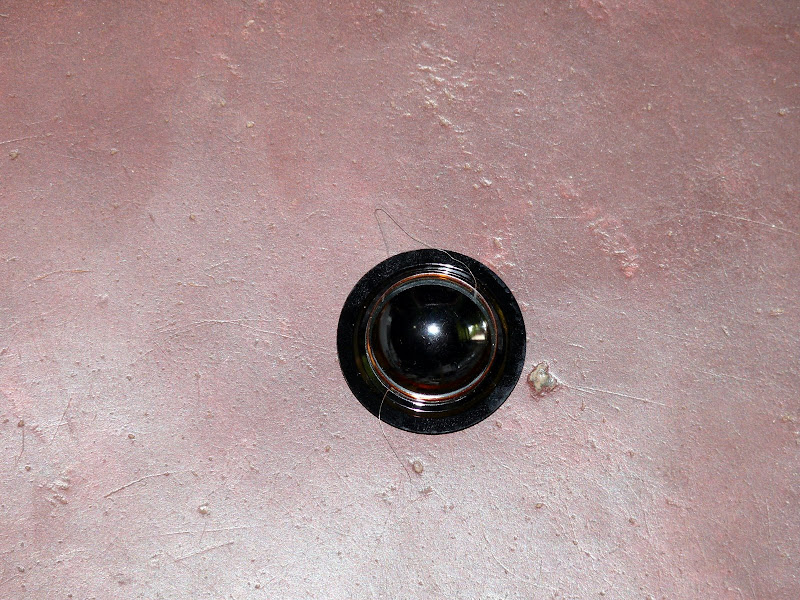

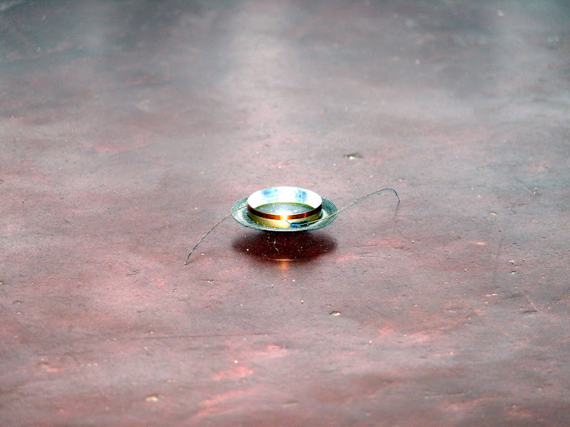

Hi, Guys update time !I have just bought some of the components required for the unit !! The basic Metal plates ( precut round ones ) The Domes (various types) Here's the pics of the same ! The Magnets The Titanium/Silk Hyrbid dome ( Top View ) Side Voicecoil View http://lh6.ggpht.com...50778.JPG?imgmax=800Bottom or upside down View |

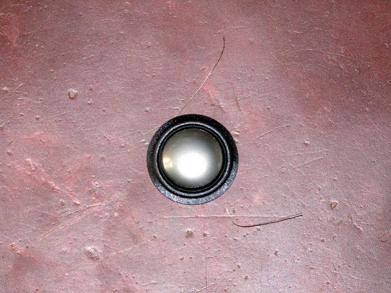

Here's the remaining stuff ! This is the PEI dome unit ! http://lh3.ggpht.com...50760.JPG?imgmax=800Top View http://lh3.ggpht.com...50769.JPG?imgmax=800Side Voice Coil View http://lh4.ggpht.com...50772.JPG?imgmax=800Bottom or upside down View As of now this is what has happened ! the plates will be turned and be ready in a day or two !! Regards. |

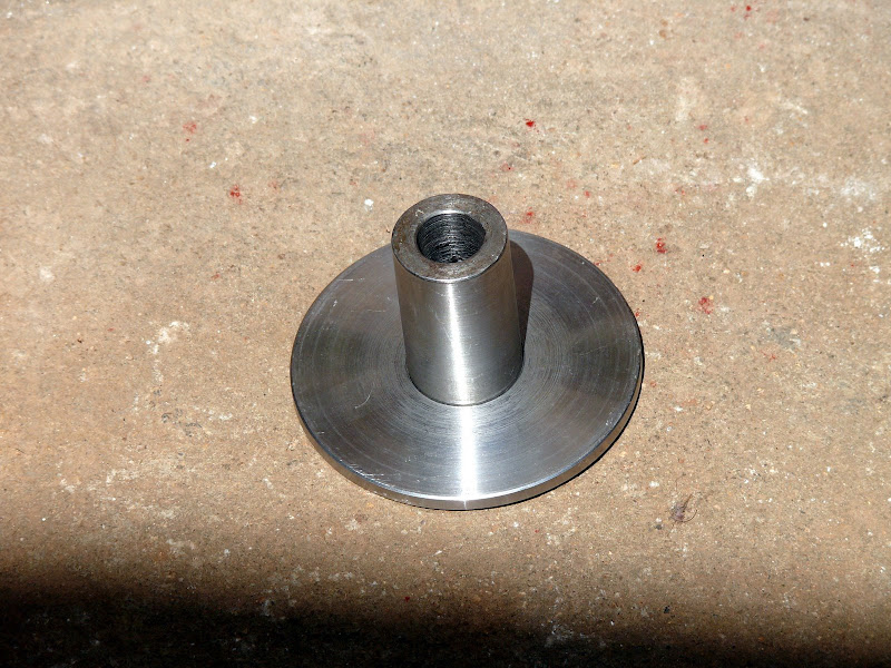

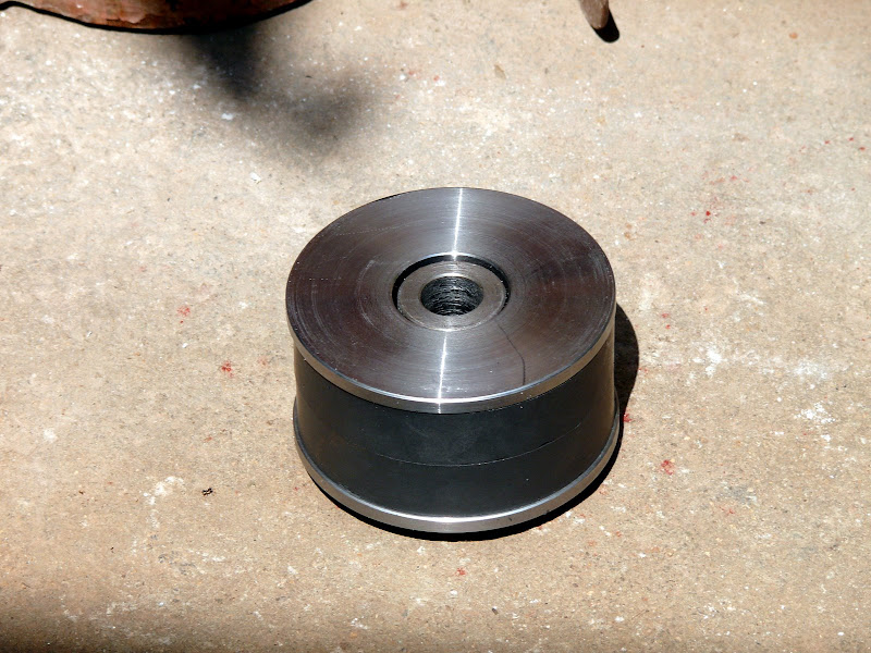

Hi, Guys its Update time :yahoo: !! I have finally got the metal pieces machined and ready for action !! Here's the pics of the same !! http://lh4.ggpht.com...8Q/s800/P1050478.JPG]http://lh4.ggpht.com...8Q/s800/P1050478.JPGTop and Bottom plates http://lh4.ggpht.com...U8/s800/P1050482.JPG]http://lh4.ggpht.com...U8/s800/P1050482.JPGThe Center Pole Piece http://lh6.ggpht.com...Gg/s800/P1050486.JPG]http://lh6.ggpht.com...Gg/s800/P1050486.JPGCenter Pole Piece different angle showing the vent http://lh3.ggpht.com...tE/s800/P1050488.JPG]http://lh3.ggpht.com...tE/s800/P1050488.JPGMock assembly of the Pole Piece and Bottom Plate [Beitrag von Soundsgreat am 22. Apr 2009, 10:41 bearbeitet] |

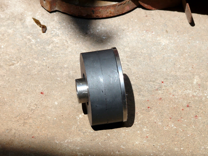

Continued........... http://lh3.ggpht.com...k4/s800/P1050490.JPG]http://lh3.ggpht.com...k4/s800/P1050490.JPGWith Magnet http://lh5.ggpht.com...DE/s800/P1050492.JPG]http://lh5.ggpht.com...DE/s800/P1050492.JPGAnother Angle http://lh5.ggpht.com...co/s800/P1050495.JPG]http://lh5.ggpht.com...co/s800/P1050495.JPGFinally with the top Plate. Guys this is just a mock assembly ;)!! Am yet to actually fix it properly with the preferred Glue and stuff !! As always please do share your thoughts and feedbacks etc...... Regards. [Beitrag von Soundsgreat am 22. Apr 2009, 10:42 bearbeitet] |
