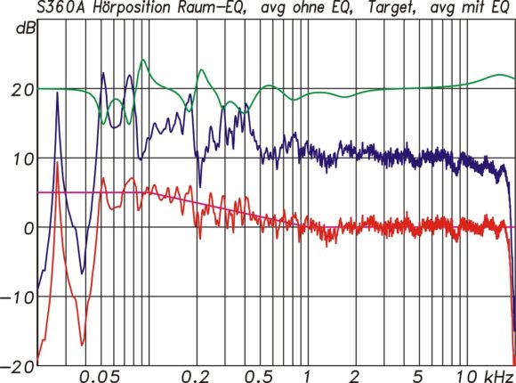

Figure 12.4 in the third edition of my book shows the evolution of a steady-state "room curve" using very highly rated loudspeakers as a guide. The population includes several cone/dome products and the cone/horn M2. The result is a tightly grouped collection of room curves, from which an average curve is easily determined. It is a gently downward tilted line with a slight depression around 2 kHz - the consequence of the nearly universal directivity discontinuity at the woofer/midrange-to-tweeter crossover. I took the liberty of removing that small dip and creating an "idealized" room curve which I attach. The small dip should not be equalized because it alters the perceptually dominant direct sound.
It is essential to note that this is the room curve that would result from subjectively highly-rated loudspeakers. It is predictable from comprehensive anechoic data (the "early reflections curve in a spinorama). If you measure such a curve in your room, you can take credit for selecting excellent loudspeakers. If not, it is likely that your loudspeakers have frequency response or directivity irregularities. Equalization can address frequency response issues, but cannot fix directivity issues. Consider getting better loudspeakers. Equalizing flawed loudspeakers to match this room curve does not guarantee anything in terms of sound quality.
When we talk about a "flat" frequency response, we should be talking about anechoic on-axis or listening window data, not steady-state room curves. A flat room curve sounds too bright.
Conclusion: the evidence we need to assess potential sound quality is in comprehensive anechoic data, not in a steady-state room curve. It's in the book.
The curve is truncated at low frequencies because the in-situ performance is dominated by the room, including loudspeaker and listener locations. With multiple subwoofers is it possible to achieve smoothish responses at very low frequencies for multiple listening locations - see Chapters 8 and 9 in my book. Otherwise there are likely to be strong peaks and dips. Peaks can be attenuated by EQ, but narrow dips should be left alone - fortunately they are difficult to hear: an absence of sound is less obvious than an excess. Once the curve is smoothed there is the decision of what the bass target should be. Experience has shown that one size does not fit all. Music recordings can vary enormously in bass level, especially older recordings - it is the "circle of confusion" discussed in the book. Modern movies are less variable, but music concerts exhibit wide variations. The upshot is that we need a bass tone control and the final setting may vary with what is being listened to, and perhaps also personal preference. In general too much bass is a "forgivable sin" but too little is not pleasant.
Average steady-state \

Abbildung 12.4 in der dritten Ausgabe meines Buches zeigt die Entwicklung einer stationären "Raumkurve" mit sehr hoch bewerteten Lautsprechern als Orientierungshilfe. Die Population umfasst mehrere Kegel-Kuppel-Produkte und den Kegel-Horn M2. Das Ergebnis ist eine eng gruppierte Sammlung von Raumkurven, aus der sich leicht eine Durchschnittskurve ermitteln lässt. Es handelt sich um eine leicht nach unten geneigte Linie mit einer leichten Vertiefung um 2 kHz - die Folge der nahezu universellen Richtungsfehler an der Tiefton-/Mittelton-/Tieftonweiche. Ich nahm mir die Freiheit, dieses kleine Dip zu entfernen und eine "idealisierte" Raumkurve zu erstellen, die ich anfüge. Der kleine Dip sollte nicht ausgeglichen werden, da er den wahrnehmungsdominanten Direktklang verändert.
Es ist wichtig zu beachten, dass dies die Raumkurve ist, die sich aus subjektiv hoch bewerteten Lautsprechern ergeben würde. Es ist vorhersagbar aus umfassenden reflexionsarmen Daten (der "frühen Reflexionskurve in einem Spinorama). Wenn Sie eine solche Kurve in Ihrem Raum messen, können Sie sich auf die Auswahl ausgezeichneter Lautsprecher verlassen. Wenn nicht, ist es wahrscheinlich, dass Ihre Lautsprecher Frequenzgang oder Richtunregelmäßigkeiten aufweisen. Die Ausgleichung kann Probleme mit dem Frequenzgang beheben, aber keine Probleme mit der Richtwirkung. Erwägen Sie, bessere Lautsprecher zu kaufen. Die Anpassung fehlerhafter Lautsprecher an diese Raumkurve ist keine Garantie für die Klangqualität.
Wenn wir von einem "flachen" Frequenzgang sprechen, sollten wir von schalltoten On-Axis- oder Hörfensterdaten sprechen, nicht von stationären Raumkurven. Eine flache Raumkurve klingt zu hell.
Fazit: Die Beweise, die wir zur Beurteilung der potenziellen Klangqualität benötigen, liegen in umfassenden reflexionsarmen Daten und nicht in einer stationären Raumkurve. Es steht im Buch.
Bei tiefen Frequenzen wird die Kurve abgeschnitten, da die In-situ-Performance vom Raum dominiert wird, einschließlich der Lautsprecher- und Hörerpositionen. Mit mehreren Subwoofern ist es möglich, bei sehr tiefen Frequenzen für mehrere Hörorte glatte Frequenzen zu erzielen - siehe Kapitel 8 und 9 in meinem Buch. Andernfalls ist es wahrscheinlich, dass es zu starken Spitzen und Einbrüchen kommt. Peaks können durch den EQ abgeschwächt werden, aber enge Dips sollten in Ruhe gelassen werden - glücklicherweise sind sie schwer zu hören: Ein Fehlen von Sound ist weniger offensichtlich als ein Überschuss. Sobald die Kurve geglättet ist, steht die Entscheidung fest, wie das Bassziel aussehen soll. Die Erfahrung hat gezeigt, dass eine Größe nicht für alle geeignet ist. Musikaufnahmen können im Bassbereich sehr unterschiedlich sein, vor allem ältere Aufnahmen - es ist der im Buch beschriebene "Kreis der Verwirrung". Moderne Filme sind weniger variabel, aber Musikkonzerte zeigen große Unterschiede. Das Ergebnis ist, dass wir eine Bassklangregelung benötigen und die endgültige Einstellung je nach dem, was gehört wird, und vielleicht auch nach persönlicher Vorliebe variieren kann. Im Allgemeinen ist zu viel Bass eine "verzeihliche Sünde", aber zu wenig ist nicht angenehm.

#37 erstellt: 22. Aug 2019, 14:20
Wie passt die Zielkurve mit -6dB Rampe von 100 nach 1000Hz welche Herr Goertz verwendet überein mit den zuvor genannten Kurven?
BTW: weiß jemand wie Herr Goertz die häuig erwähnten 30 Messungen macht? Je nachdem wo die Messpunkte sind kann/ wird eine Gewichtung stattfinden...
[...]Wie immer wurden zunächst für jedenLautsprecher jeweils 30 Messungen im Umfeld der Hörplatzes gemacht, die dann energetisch gemittelt wurden und so für die Einstellung der Filter genutzt werden konnten.[...]
Bsp:
Gemittelte Frequenzgangmessung für die S360A mit je 30 Positionen für den linken und rechten Lautsprecher um den Hörplatz (blaue Kurve). Daraus abgeleiteter Raum-EQ in Grün und der gemittelte Verlauf mit EQ in Rot; Zielfunktion mit 6-dB-Rampe in Magenta
thewas
#38 erstellt: 22. Aug 2019, 14:43
Es sind -5dB und die passen im Bereich 100-1000 Hz ziemlich gut zu der -10dB insgesamt der Harman Kurve, nur dass zweite auch weiter im Hochton abfällt was mehrere andere Leute wie Mitchco (und ich) sinnvoller finden. Darum muss Herr Goertz im oberen Hochton bei den meisten neutralen Lautsprecher wie bei der S360 auch im oberen Hochton etwas hinzufügen was ich eher nicht tue. Wobei Zielkurven auch von dem Nachhallzeitverlauf der Räume abhängen und ich vermute dass bei ihm diese sehr konstant ist ab 1kHz.
Ich vermute seine Messpunkte sind ziemlich gleichmäßig um den Hörplartz verteilt, wobei bei persönlichen Experimentieren bei mir die Unterschiede sehr gering sind.
